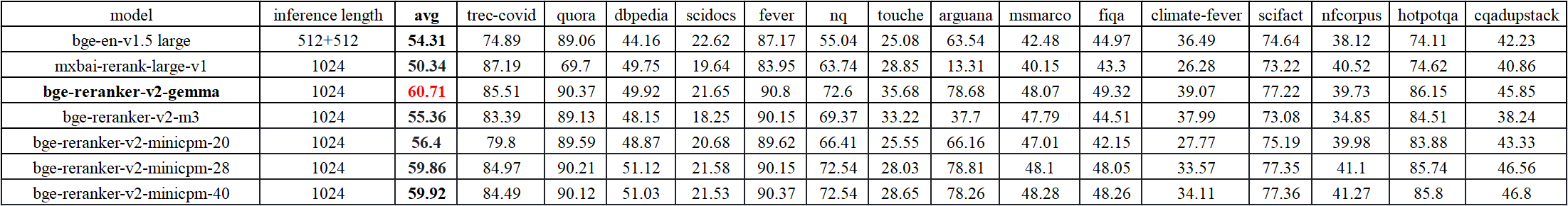

  • BEIR.
rereank the top 100 results from bge-en-v1.5 large.

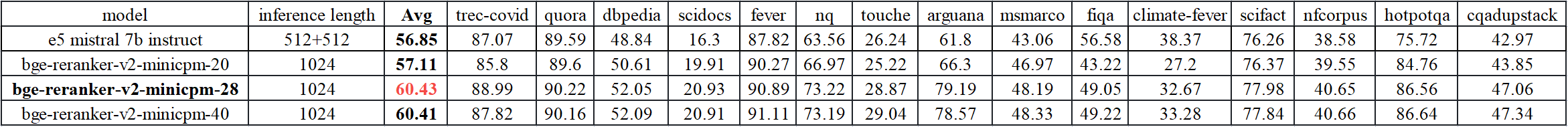

image-20240317174633333
rereank the top 100 results from e5 mistral 7b instruct.

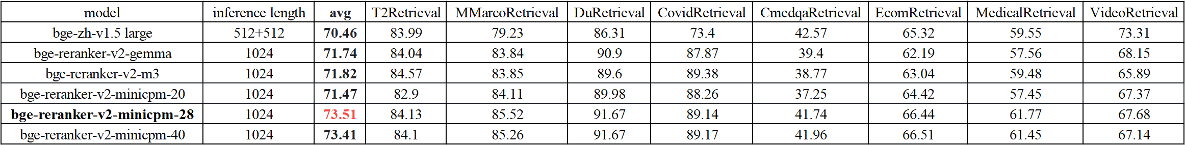

  • CMTEB-retrieval.
    It rereank the top 100 results from bge-zh-v1.5 large.

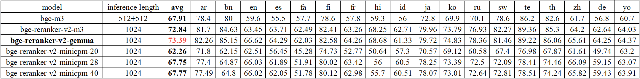

  • miracl (multi-language).
    It rereank the top 100 results from bge-m3.
